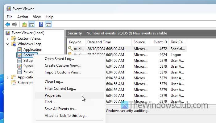

To set the maximum log size using Event Viewer, open it first. You can search for event viewer in the Taskbar search box and click on the individual search result – or press Win+R, type eventvwr and hit the Enter button.
Once it is opened, expand the Windows Logs section, right-click the Security menu, and choose the Properties option from the context menu.

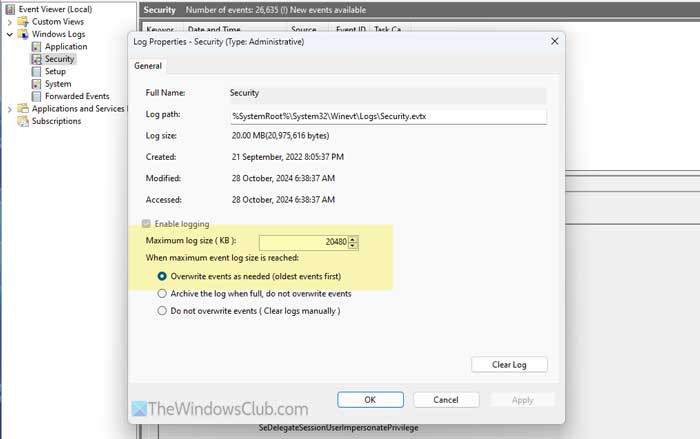

Here you can find an option called Maximum log size. If it is set to anything lower than 10240, set it as 10240. However, if it is set to 10240, set it as 20480.
Then, ensure that the overwrite events as needed option is selected.
Finally, click the OK button to save the change.

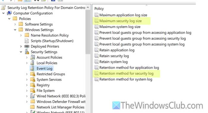

Click on the Domains option and choose the domain your computer is connected to. Then, select the Group Policy Objects, right-click on the Default Domain Controllers Policy, and choose the Edit option from the right-click context menu.
After that, navigate to this path:
Computer Configuration > Policies > Windows Settings > Event Log
Here, you can find an option called Maximum security log size. Set the maximum log size as 10240. However, if it is already set to 10240, set it to 20480.
Then, head to the Retention method for security log and choose the Overwrite events as needed option.
Finally, click the OK button to save all the changes.
