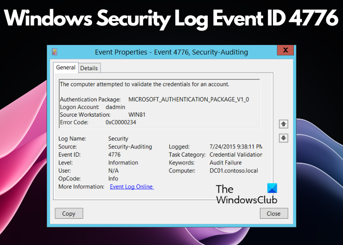

Do you notice a series of Security Log Event ID 4776, The computer attempted to validate the credentials for an account in the Windows Event Viewer? There’s nothing to worry if it’s a success. But it’s a matter of concern if you see several failed attempts of the Event ID. You can identify the Event ID 4776 failure with unknown usernames or login attempts, incorrectly spelled names, or when someone is trying to access dead accounts.
But if you see Event ID 4776 – The domain controller attempted to validate the credentials for an account or The computer attempted to validate the credentials for an account, it provides you with some critical details regarding the sources of these attempts. In this post, we will discuss the significance of this message.
What is Event ID 4776?
Event ID 4776 is a log event in the Domain Controller (DC) or local SAM that has been used as the log-on server to verify the credentials of an account using NTLM (NT LAN Manager). This event is logged for Domain Controllers, workstations, and Windows servers. NTLM is the default verification system for local logon.
Each time there is a logon attempt on a domain controller it gets recorded in DC and once it authenticates the credentials (success/failure) via NTLM, it logs the Event ID 4776. Also, for a logon attempt via a local SAM account (server/workstation authenticates credentials), the event ID 4776 is logged on to the local machine.

- Error Code – This indicates whether the verification was a success or a failure. If the error code shows 0x0, this means that the credentials were successfully validated. If it’s not 0x0 then it means that the credentials were not validated. In this case, the field will show Authentication Failure – Event ID 4776 (F).

3] Check the accompanying error code
The accompanying error code will indicate the direction you will have to troubleshoot.
| Error Code | Description |
| 0xC0000064 | The username you typed does not exist. Bad username. |
| 0xC000006A | Account logon with a misspelled or bad password. |
| 0xC000006D | – Generic logon failure. Some of the potential causes for this: An invalid username and/or password was used LAN Manager Authentication Level mismatch between the source and target computers. |
| 0xC000006F | Account logon outside authorized hours. |
| 0xC0000070 | Account logon from unauthorized workstation. |
| 0xC0000071 | Account logon with expired password. |
| 0xC0000072 | Account logon to account disabled by the administrator. |
| 0xC0000193 | Account logon with expired account. |
| 0xC0000224 | Account logon with “Change Password at Next Logon” flagged. |
| 0xC0000234 | Account logon with account locked. |
| 0xC0000371 | The local account store does not contain secret material for the specified account. |
| 0x0 | No errors. |
