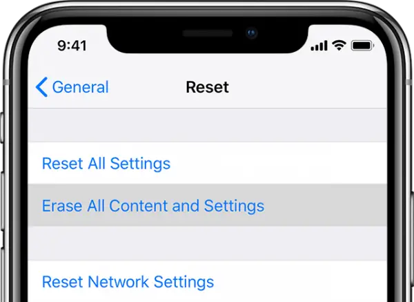

2] Using Factory Reset
You can Factory reset your iPhone, iPad or iPod – and as you do that, connect that device to your computer with iTunes running.
Now, iTunes will give you a prompt to restore your iPhone, iPad or iPod.
You can follow the on-screen instructions and then restore your iOS device properly.
