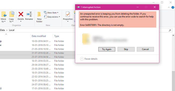

When trying to delete a folder, you may encounter an error message that implies that the directory is not empty. However, when trying to speculate on the issue, we noticed that the folder is vacant and there might be some other plausible explanation for this issue. So, in this post, we are going to see what to do if you get Error 0x80070091 that says The directory is not empty.
An unexpected error is keeping you from deleting the folder. If you continue to receive this error, you can use the error code to search for help with this problem. Error 0x80070091: The directory is not empty.
What is error 0x80070091 The directory is not empty?
It mainly occurs when you try to delete a folder from an external hard disk, SD card or pen drive, but it can also happen when deleting a file from the system drive.
Error 0x80070091 The directory is not empty on Windows 11/10
Before you begin, restart your computer and try again. If you still receive this error, then you may need to troubleshoot the issue further. Since you are receiving an error that says “Error 0x80070091 The directory is not empty”, follow these solutions.
