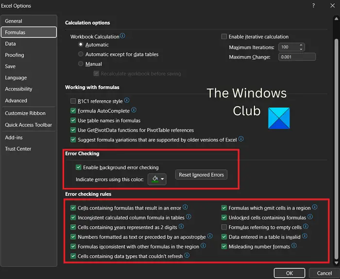

Background error checking is enabled on Microsoft Excel by default. However, if a third-party extension disabled it or another user disabled the option, it can be re-enabled again as follows:
- Launch Excel
- Click on File.
- From the menu, select Options.
- Go to the Formulas tab.
- In the Error checking section, check the box associated with Enable background error checking.
- If you wish to disable Background error checking, then simply uncheck the box.
- Click on OK to save the settings.

How to change the color for Background error checking in Excel?
The color for errors marked through the Background error checking process are all green. This is because green is the default color for these marked errors. You can change this color as well. The procedure is as follows:
- Go to the Formulas window as explained earlier.
- In the Error checking group, you will find an option for Indicate error using this color.
- Change the color from the drop-down menu.

How to modify Error checking rules in Microsoft Excel?
The Background error checking is dependent on a set of rules which can be modified. Basically, these rules indicate which figure or formula will be marked as an error. The procedure to change these error-checking rules is as follows:
- You will notice options with checkboxes.
- Check a box to enable the associated option and uncheck the box to disable the associated option.
