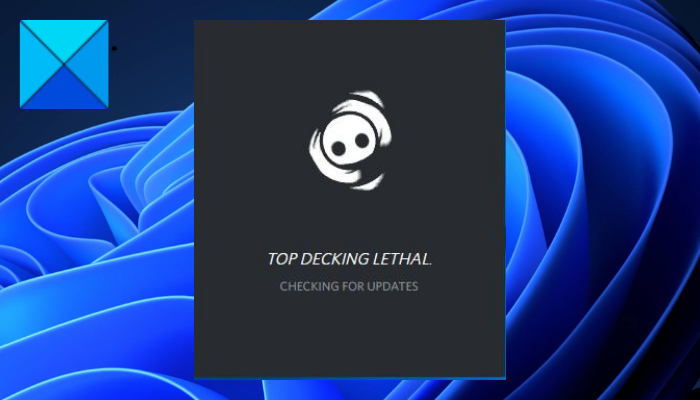

Is your Discord stuck on the CHECKING FOR UPDATES screen? Discord is a popular VOIP service used by millions of gaming enthusiasts worldwide. While it has made communication amongst gamers a lot easier, it has its own share of issues and bugs. Many Discord users have reported being stuck on the CHECKING FOR UPDATES screen whenever they try to update the app. Downloading and installing updates is very important as it improves the performance and stability of the app. So, this issue can be very annoying and frustrating.
Now, if you are one of the affected users facing the same issue, this guide is for you. In this post, we are going to discuss several fixes that will help you get rid of the “Discord stuck on CHECKING FOR UPDATES” issue. So, without much ado, let us get straight to the solutions now.
