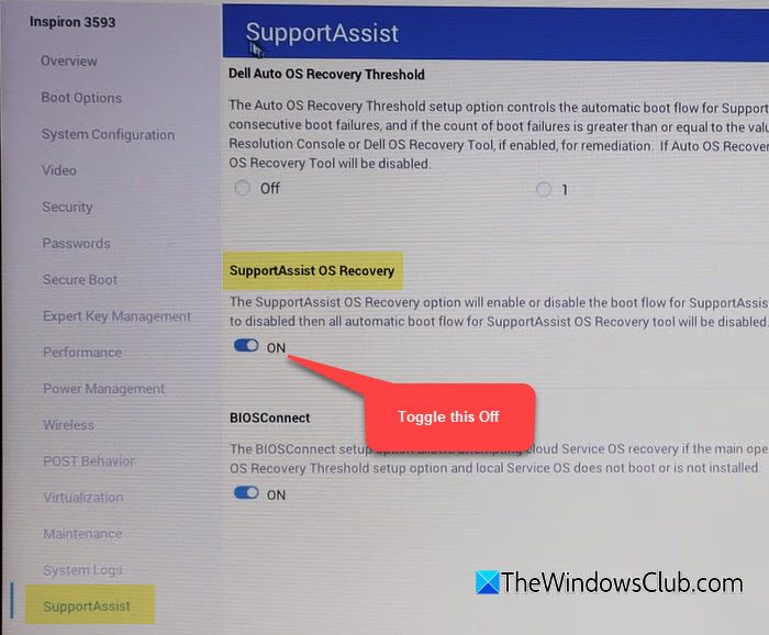

3] Disable the Dell SupportAssist pre-boot system performance check
Restart your system. When the Dell logo is displayed, press the F2 key repeatedly to access the BIOS Setup.
In the left pane, navigate to SupportAssist System Resolution or SupportAssist or Update,Recovery depending on your BIOS version.
In the right pane, clear the SupportAssist OS Recovery check box or toggle off the SupportAssist OS Recovery switch.
Press F10 to save changes and exit the BIOS.
After disabling the setting, your system will skip the pre-boot check on future startups unless you trigger it manually.

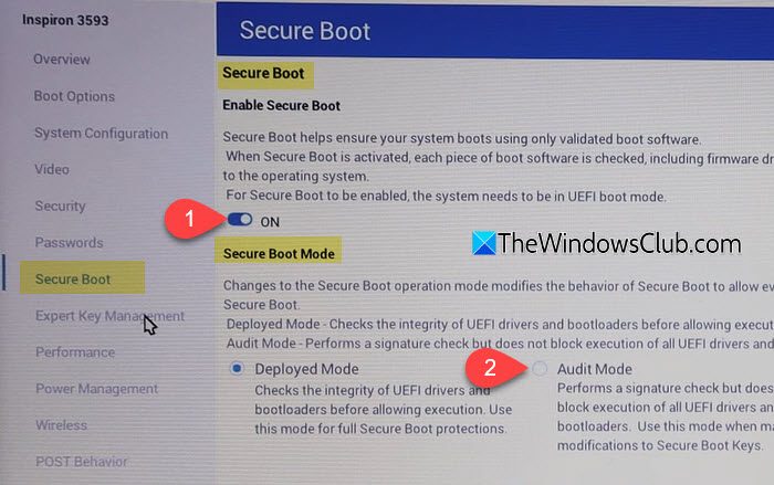

4] Enable Secure Boot and change Boot Mode to Audit
This solution might help bypass the issue if your Secure Boot settings are misconfigured.
Restart your system and press F2 repeatedly during startup to enter the BIOS/UEFI settings. Navigate to the Boot or Security tab (depending on your system) and locate the Secure Boot option. Ensure that Secure Boot is set to Enabled.
Under the Secure Boot settings, look for the Secure Boot Mode option and change it to Audit mode.
Press F10 to save changes and exit the BIOS/UEFI.
