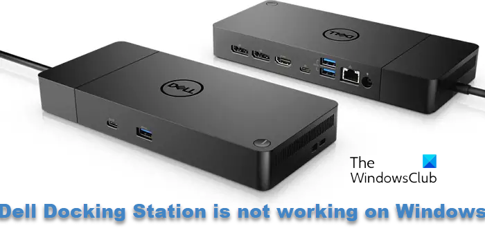

The Dell Docking station is a must-have tech as computers and laptops limit our ports. The docking system lets you connect different peripherals to your laptop or PC, such as an external monitor, keyboard, mouse, etc. However, what if your Dell Docking Station is not working on Windows 11?
That is undoubtedly something to worry about. But don’t worry; this post will discuss several issues with the Dell Docking station and how to fix them. So here we go.
There can be multiple reasons why the docking station won’t work on a Windows PC. Here is a list of troubleshooting steps to help you with various issues.
