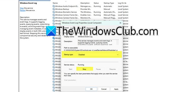

Open Windows Services by opening Run (Win + R), type “services.msc”, and click OK.
Now, you need to look for the Event Log (or Windows Event Log) Service, right-click on it, ans select Properties.
In the General tab, set the Startup type to Disabled, and click on Stop.

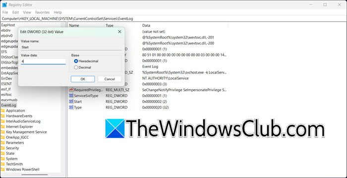

Open the Registry Editor and go to:
HKEY_LOCAL_MACHINE\SYSTEM\CurrentControlSet\Services\Eventlog
Look for the Start value, double-click it, and set its Value data to 4. Then click OK.
