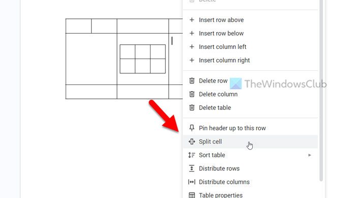

1] Using Split cell
To create a table within a table in Google Sheets using the Split cell option, follow these steps:
- Make sure the cell is selected in your first primary table.
- Right-click on the cell where you want to show the secondary table.
- Select the Split cell option from the right-click context menu.
- Enter the number of rows and columns.
- Click the Split button.
For your information, you can enter a maximum value of 10×10. It displays the second table instantly like this:

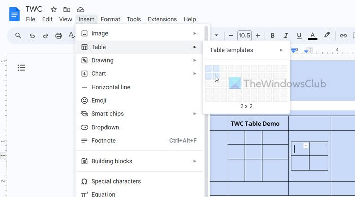

2] Using the Insert Table option
To create a table within a table in Google Docs using the Insert Table option, follow these steps:
- Select the cell in your primary table where you want to display the table.
- Click on the Insert option in the top menu bar.
- Select the Table option.
- Choose the number of rows and columns.
In this case, you can find a limit of 20×20 tables at most.

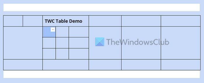

Can I put a table inside a table in Google Docs?
Yes, you can put a table inside a table in Google Docs. As mentioned in the article, there are two ways to do that. First, you can split a specific cell using the Split cell option. Second, you can manually add a secondary table inside any cell of your existing table.
