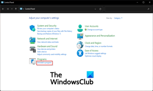

Firstly, log in to Windows with an Administrator account. Next, press the Windows key, and type Control Panel. Click on Control Panel to open it. Click on the dropdown beside View by at the top right-hand side of the page and select Category.
Next, select Uninstall a program under the Programs category.
