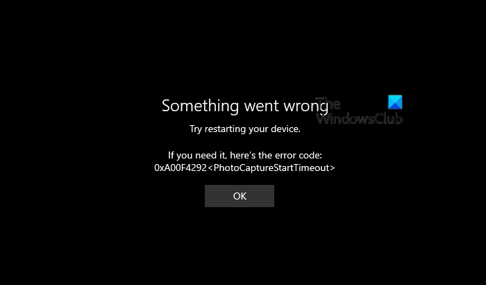

While trying to access the Camera app in Windows, an error message bearing the following description comes up – Something went wrong. Try restarting your device. If you need it, here’s the Camera error code 0xA00F4292 <PhotoCaptureStartTimeout>. Also, upon investigating a bit, the camera does not show in Device Manager too. Here’s how to troubleshoot the issue.
Fix Camera error code 0xa00f4292 <PhotoCaptureStartTimeout> in Windows 11/10
There can be many reasons why the Camera app behaves weirdly. Nevertheless, you can try the following methods to fix the problem. But first, restart your device and see if it helps.

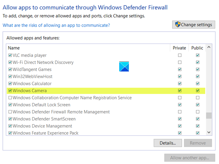

5] Allow the Camera Access through Antivirus/Firewall
Go to the Control Panel.
Select Windows Defender Firewall.
Choose Allow an app or feature through Windows Defender Firewall from the left sidebar.
Locate the Camera app in the list.
Uncheck the boxes next to Private and Public columns.
Click OK.
