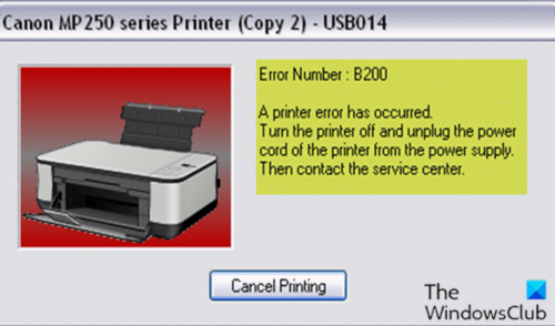

When you encounter this issue. you’ll receive the following full error message;
Error Number : B200
A printer error has occurred.
Turn the printer off and unplug the power cord of the printer from the power supply. Then contact the service center.
