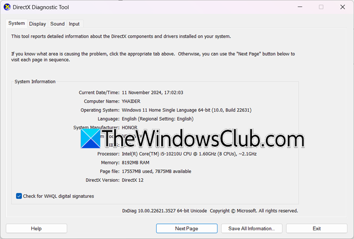

1] Check if your computer meets the system requirement
If you are unable to install AutoCAD on your computer, you should first check if your system meets the requirements issued by the developer. We have listed the system requirements for Windows below.
- OS: Windows 11/10 (64-bit)
- Processor: 3+ GHz
- Memory: 16 GB
- Display: 1920 x 1080 (or better)
- Display Card: 4 GB GPU with 106 GB/s Bandwidth and DirectX 12 compliant
- Available Space: 10 GB
- Features: .NET Framework version 4.8 or later
To know what your system’s specifications are, open Run, type ‘dxdiag’, and click Ok. Finally, you can see if your computer is compatible with AutoCAD, if it is not, you need to increase your system’s resources and then try installing AutoCAD. Hopefully, after allocating a few more resources, you will be able to install the application.

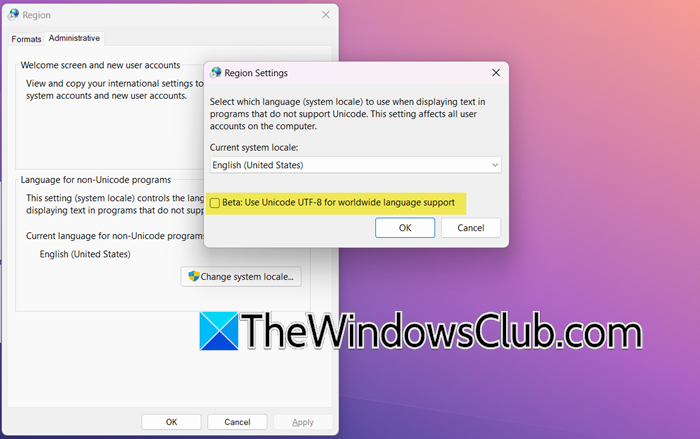

2] Disable Beta: Use Unicode UTF -8 for worldwide language support feature
The Beta: Use Unicode UTF -8 for worldwide language support feature allows your computer to improve compatibility with apps that use Unicode UTF-8 encoding for non-Unicode programs. However, the feature has been known to cause issues with AutoCAD, especially during installation, saving, exporting, and using e_Transmit. In order to resolve the issue, we are going to disable it. To do so, follow the steps mentioned below.
- Open Control Panel.
- Go to Clocks and Region and then click on Region.
- Now, go to the Administrative tab and then click on Change system locale.
- You then have to untick Beta: Use Unicode UTF -8 for worldwide language support and click Ok.
Finally, reboot your computer, and run the installation process. Hopefully, it will do the trick for you.

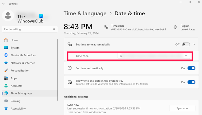

4] Check your date, time, and timezone
You need to make sure that your timezone is that of your region, and that other aspects such as date and time are correct. Otherwise, AutoCAD will get confused and will refuse to install. In order to resolve this issue, we are going to check everything and make sure that they are in place. To do so, follow the solutions mentioned below.
- Open Settings by Win + I.
- Go to Time & Language > Date & time.
- Ideally, the Set time zone automatically should be checked, but even if you encounter this issue, go ahead and disable it.
- Then, set the Time Zone to the correct timezone.
- Make sure that the date and time are correct on the same interface.
Finally, run the installation media and then see if the issue is resolved. This should do the trick for you.
