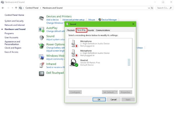

1] Check device settings for your microphone
Bear in mind that your Astro A50 microphone might be disabled, so we have to enable it if such is the case. So, here’s what we’re going to do, click on the Windows Key + R which should bring up the Run dialog box. Inside the box, type control then hit the Enter key.
Doing this should launch the Control Panel. The next step, then, is to click on Hardware and Sound, and select Sound from the list. A new window should pop up, so from here choose the Recording tab, and select Show Disabled Devices.
Next, go on ahead an right-click on Headset Microphone and select Enable from the options given to you. Right-click it once more and choose Set as Default Device, then finally, click on OK, restart your computer, and check to see if your mic is working properly.
