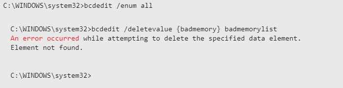

C:\WINDOWS\system32>bcdedit /enum all
C:\WINDOWS\system32>bcdedit /deletevalue {badmemory} badmemorylist An error occurred while attempting to delete the specified data element. Element not found.
