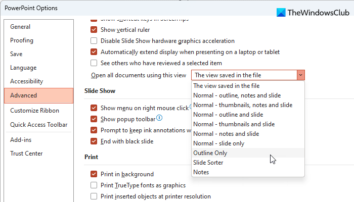

To get started, open PowerPoint on your computer and click on the File menu. Then, click the Options visible in the bottom-left corner. It opens the PowerPoint Options panel.
Next, you need to switch to the Advanced tab and head to the Display section. Here you can find an option called Open all documents using this view.
You need to open the menu and select one option among Outline Only, Slide Sorter, and Notes.
Finally, click the OK button to save the change.

To change the default slide settings in PowerPoint, you must go through the aforementioned steps. In other words, open File and go to Options. Then, switch to the Advanced tab and find the Open all documents using this view option. Expand the drop-down list and choose a view as per your requirements.
How do I view PowerPoint in slide Sorter?
To view PowerPoint in Slide Sorter mode, you can follow this guide as mentioned above. First, open the PowerPoint Options panel on your computer and switch to the Advanced tab. Then, expand the Open all documents using this view list and choose the Slide Sorter option. Finally, click the OK button to save the change.
