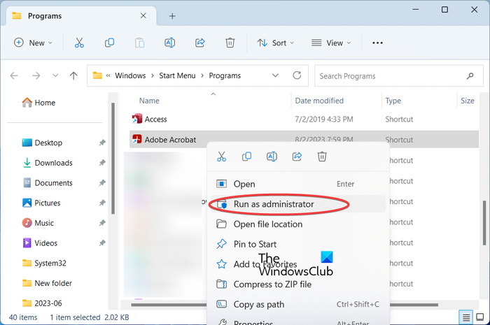

1] Run Adobe Acrobat DC as an administrator
The first thing you can do to fix this issue is try launching Acrobat DC with administrator rights. It might be missing administrator rights causing the problem. So, run the Adobat DC app as an administrator and check if it opens correctly or not. Before doing that, make sure no instance of Acrobat DC is opened in the background. Let us check out how to do that:
- First, open Task Manager using the Ctrl+Shift+Esc hotkey.
- Now, check whether a process related to Adobe Acrobat DC is running in the background. If yes, close it using the End task button.
- Once done, go to the Adobe Acrobat DC desktop shortcut and right-click on it.
- From the appeared context menu, choose the Run as administrator option and press Yes on the UAC prompt.
Check if the app launches correctly now. If yes, you can make Acrobat DC always run with administrator privileges. However, if this method doesn’t help, move on to the next solution.

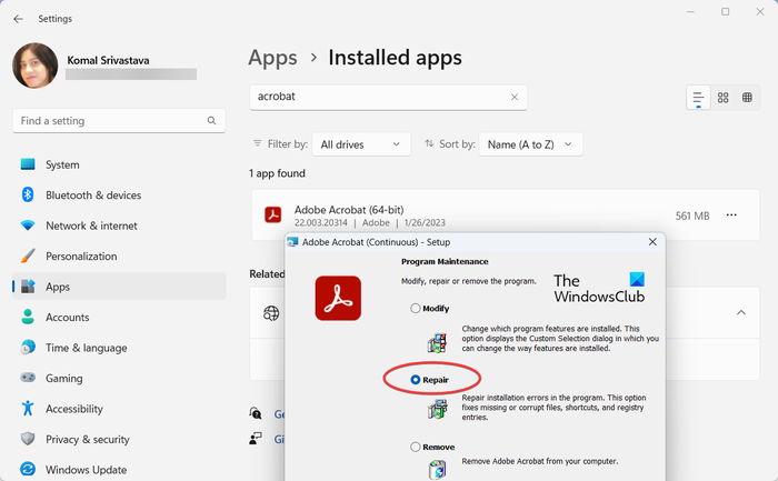

3] Repair Adobe Acrobat DC
If the installation of Acrobat DC is broken or corrupted, it won’t open or launch, and you won’t be able to use it. Hence, if the scenario applies, repair the app and then try opening it to check whether the problem is fixed. Here’s how you can do that:
- First, press Win+I to open the Settings app and move to the Apps > Installed apps section.
- Now, locate the Adobate Acrobat DC app and click on the three-dot menu button present next to it.
- After that, choose the Modify option from the appeared option.
- A new window will open up. Select the Repair option and then press the Next button.
- Next, press the Update button and let it repair the application.
- Once done, check whether you can open Acrobat DC.

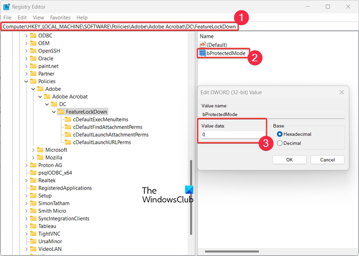

4] Disable protected mode using Registry Editor
Some affected users have reported that making a registry tweak helped them fix this issue. You can try turning off Acrobat DC’s protected mode using Registry Editor and then see if it works.
The Protected Mode is a security feature that helps Acrobat DC prevent you from opening malicious files. However, it can also generate false alarms and prevent you from opening the app. If this scenario applies, you should be able to fix the problem by turning off protected mode. To do that, you will be required to make a registry tweak. Before doing that, make sure you create a backup of your Registry to be on the safer side. Let’s see how.
First, open Run with Win+R, then enter regedit in the Open box to quickly open your Registry Editor app.
Now, navigate to the following key in your address bar:
Computer\HKEY_LOCAL_MACHINE\SOFTWARE\Policies\Adobe\Adobe Acrobat\DC\FeatureLockDown
Next, on the right side, right-click on the empty part and choose the New > DWORD (32-bit) Value option from the appeared context menu. Then, name this newly created DWORD as bProtectedMode.
After that, double-click on the bProtectedMode key and make sure its value is set to 0.
Once done, open Acrobat DC and check if the problem is resolved.

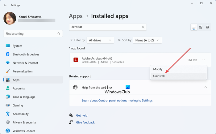

5] Update or reinstall Adobe Acrobat DC
The next thing you can do to fix this issue is update the Adobe Acrobat DC app to its latest version. If that doesn’t help, uninstall the program and then reinstall it to open and use the app correctly.
You can download the latest version of Acrobat DC from its official website and then install it on your computer. If that helps, well and good. However, if that doesn’t work, you will be required to perform a clean install of the Acrobat DC app. To do that, first, uninstall it completely from your computer. Here’s how:
- First, open Settings using Win+I and go to Apps > Installed apps.
- Now, click on the three-dot menu button present next to Acrobat DC and choose Uninstall.
- Next, follow the prompted instructions and remove the app from your PC.
- Then, make sure to remove all leftover or residual files associated with the app.
After that, download the latest version of Acrobat DC and install it. You should now be able to open and use it without any issues.
