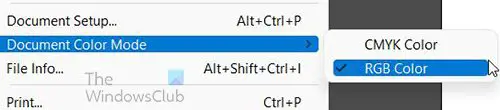

Make sure that the document is in the RGB color mode by going to File then Document Color Mode. You may see the CMYK color mode selected, just select RGB. RGB is the color mode that will work for PowerPoint.

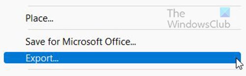

Go to File then Export to start the process of making the image compatible with PowerPoint.

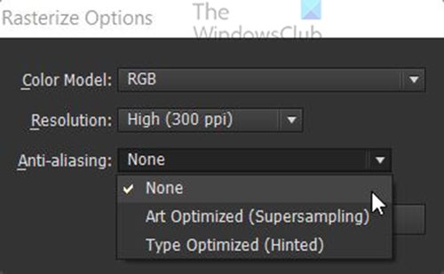

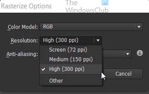

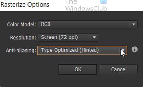

When you click Save the Rasterize Option window will appear.
Choose for Resolution High (300 ppi).
Choose for Anti-Aliasing None. Click Ok to confirm the options.

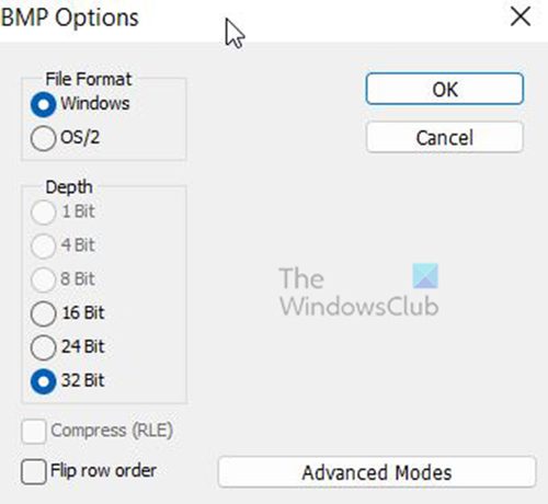

The BMP Options window will appear. Choose Windows for File Format and 32 Bit for the Depth then click OK. The Illustrator file will be exported as a high-quality BMP file.

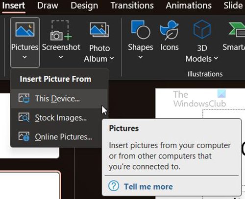

Choose the slide that you want the BMP image on and go to the top of the window and press Insert then Picture then click This Device. The Insert Picture window will appear, search for the location of the BMP file, click it, and Click Insert. The image will be placed in PowerPoint. You can resize it to fit your needs.
