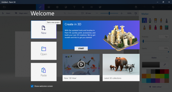

Download and install Paint 3D on your system. Download the application from the Microsoft Store.
Once the software is installed, Open the Paint 3D application.
Create a new project by clicking on the New option from the menu bar.

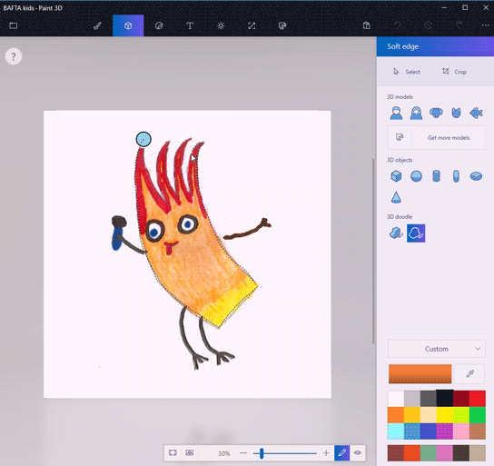

Once the drawings are ready, navigate to 3D shapes in the menu bar.
Search and choose the 3D shape that suits best for your doodle or shapes. For example, if your shape is an emoji face, you can select a 3D sphere.

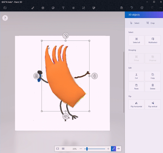

Now trace the shape with the 3D tool. You can also trace each segment separately.
Once the tracing is complete, drag all the image parts to another side of the canvas to create a 3D object.

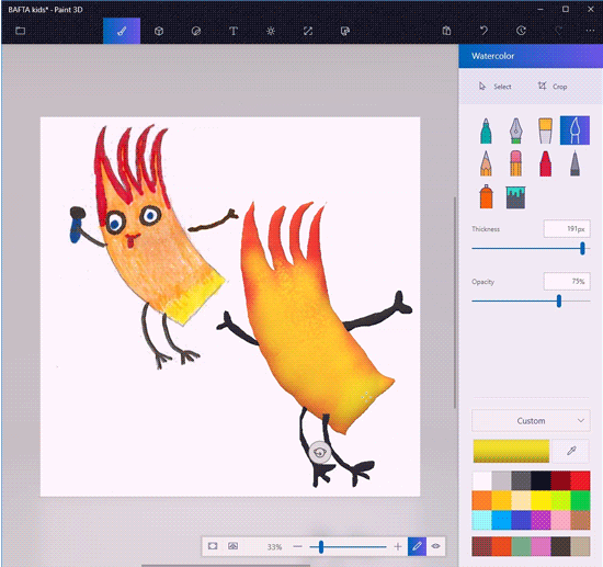

To color the 3D object, go to Art tool from the menu bar. You can make use of paint and other drawing tools like eyedropper fill bucket and so on directly on the 3D object. Eyedropper tool eases your task of finding the best color that matches perfectly for your 2D doodle. The fill tool lets user paint the object with same colors as in 2D shape.

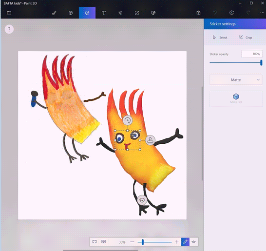

There is also an option called sticker that partially creates a 3D model by adjusting the background from the canvas.
To use the sticker, simply trace and select the 2D image components.
Click on Make 3D option under the 2D selection.
Click on Make sticker from the 3D objects sidebar.
Drag the sticker. Reposition it to fit the desired shape.

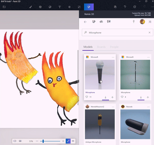

You can also make use of Remix3D that offers 3d designs and share the 3d models for others to view in the community.
