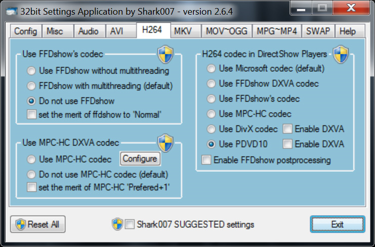

Next, download Shark007’s Codec Pack for Windows 7.
123 600x395 Resolve common Video Playback problems and issues on Windows 7
These are Windows Media Play Codecs and that’s all you need to play almost all the formats.
The Codec pack contains a Settings Application, to be used in conjunction with your Windows Media Center setup. This which will enable each user to choose different splitters and decoders for specific file types. The application will also allow you to choose from 10 different speaker configurations from ‘same as input’ and all the way up to full 7.1 channel output.
