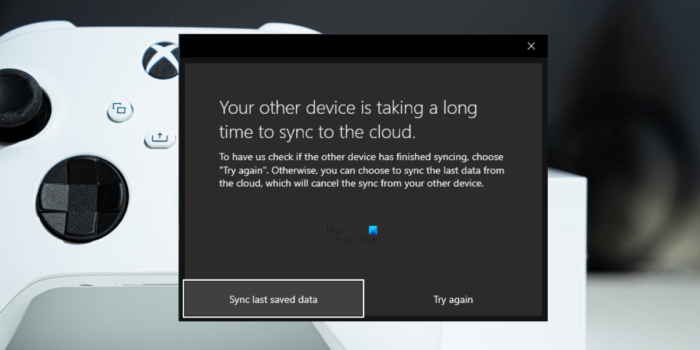

When you play games on Xbox online, your data will be saved to the cloud automatically. This allows you to play the games from where you left them on another Xbox console by signing into your account. Usually, Xbox does not take a long time to sync data to the cloud, but some users get the “Your other Xbox is taking a long time to sync to the cloud” error message on their Xbox Consoles. Clicking on the Try again button does not bring any change for some users. If you see this error message, the solutions provided in this article will help you fix the problem.
Xbox shows the “Your other Xbox is taking a long time to sync to the cloud” error message usually when the user has played the game on another Xbox and that Xbox has not completed the syncing yet. However, there could be other reasons too that trigger this error. The following solutions will help you resolve this issue on your Xbox Console. Use these solutions in the exact order they are mentioned here.

1] Check your internet connection
These types of problems also occur due to an unstable internet connection. Check if your internet connection is working fine or not. If you have an ethernet cable, connect your Xbox Console with that cable and try again. If the issue was occurring due to a network glitch, this will fix the problem. You should also restart your router to fix the network glitch.
If your internet connection is working fine, the problem might be associated with another Xbox Console. Now, proceed ahead to the next solution.
2] Complete sync on another Xbox Console
As mentioned above, the major advantage of cloud save is that you can play your games on another Xbox Console simply by signing in to your profile. If you have played the game on another Xbox Console, say on your friend’s console, the problem might be occurring due to incomplete sync on that console.
To make it easy to understand for you, let’s name the Xbox Consoles A and B. Xbox Console A is the console on which you are experiencing the error and Xbox Console B is the console on which you played the game before, say your friend’s console.
Now, keep the Xbox Console A open and contact your friend or any other person to turn on Xbox Console B and sign in to your profile on console B. After signing in to your profile, load your saved game data and let Xbox Console B finish syncing it to the cloud. Once console B finishes the sync process, select Try again on Xbox Console A and wait till console A checks if another device has finished syncing. After that, you can sign out of another console (Xbox Console B). This should fix the issue.
