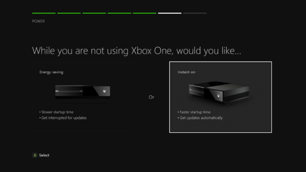

4] Make changes to the Energy Saver
Launch the Settings app on your Xbox One, then select Power and Startup. Here you should see Power options, be sure to select Power mode then use the A key on your Xbox One controller to toggle off Energy Saving.
Finally, you’ll want to click on the Save button then exit the application. For save measures, restart the Xbox One again then make another attempt to see if your mic is working properly once more.
