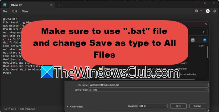

To do so, open Notepad and paste the following lines of code.

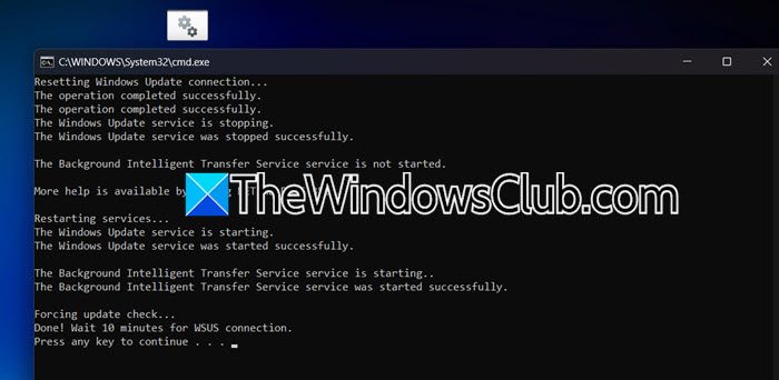

Now, save the Notepad file with a .bat extension on your Desktop (you can save it anywhere, it’s just that the Desktop is easily accessible). Finally, right-click on your batch and select Run as administrator. Click on “Yes” when prompted and let the batch file run. Hopefully, this will do the job for you.
