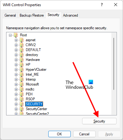

After performing a rebuild attempt on WMI Values, follow the steps below to check the WMI permissions:

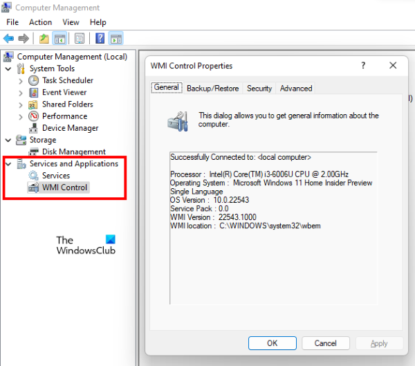

Right-click on This PC icon on your desktop and select Manage. This will launch the Computer Management Panel.
Double-click on Computer Management (Local) on the left side to expand it. After that, expand Services and Applications by double-clicking on it. Now, right-click on WMI Control and select Properties. The WMI Control Properties dialog box will appear.

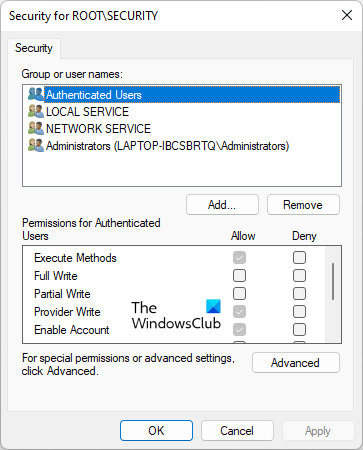

Select the Security tab and expand the Root folder. After that, select the Security subfolder and then click on the Security button on the bottom right side. This will bring the Security for ROOT dialog box on your screen.
The following permissions should be enabled for the Authenticated Users.
- Execute Methods
- Provider Write
- Enable Account
Click OK to close the Security for ROOT dialog box. Close the Computer Management panel and restart your computer. Now, check if the issue persists.

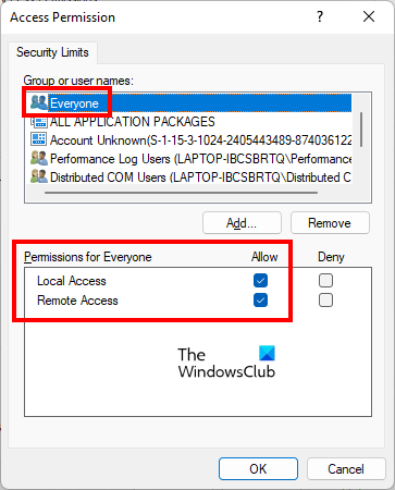

Go to “Component Services > Computers > My Computer.” Right-click on My Computer and select Properties. The My Computer Properties dialog box will appear. Select the COM Security tab.
Click on the Edit Limits button under the Access Permissions section. This will open the Access Permission dialog box. Select the Everyone user group and check if the following permissions are granted to it or not:
- Local Access
- Remote Access
If the Allow checkbox is not selected for both the above-mentioned permissions, select them and click OK.

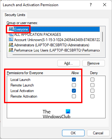

On the My Computer Properties dialog box, click on the Edit Limits button under the Launch and Activation Permissions section. Select the Everyone user group and check if the following permissions are allowed or not:
- Local Launch
- Local Activation
Click Apply and then OK to close the My Computer Properties dialog box.

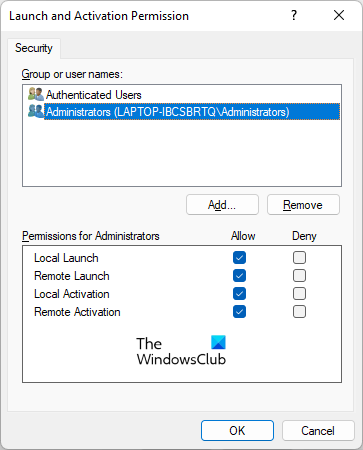

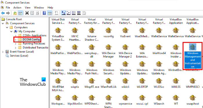

Now, in the Computer Services window, go to “Component Services > Computers > My Computer > DCOM Config.” Scroll down the right side and locate Windows Management and Instrumentation. Once you find it, right-click on it and select Properties.
Select the Security tab and click on the Edit button under the Launch and Activation Permissions section. Select Administrators under the user group and check if the following permissions are allowed to it or not.
- Local Launch
- Remote Launch
- Local Activation
- Remote Activation
If the checkboxes are not selected, select them and click OK.
