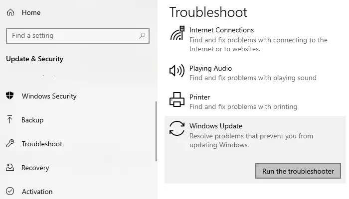

1] Use the Windows Update Troubleshooter
Windows Update Troubleshooter is the one the simplest method you can try to fix the issue on your Windows PC.
To do this, open the Windows Settings > Update and Security and then select the Troubleshoot tab.
Now switch to the right pane, select Windows Update, and then hit the Run the troubleshooter button.
Furthermore, you can also try Microsoft’s online troubleshooter and check whether it helps you to get rid of this problem.
