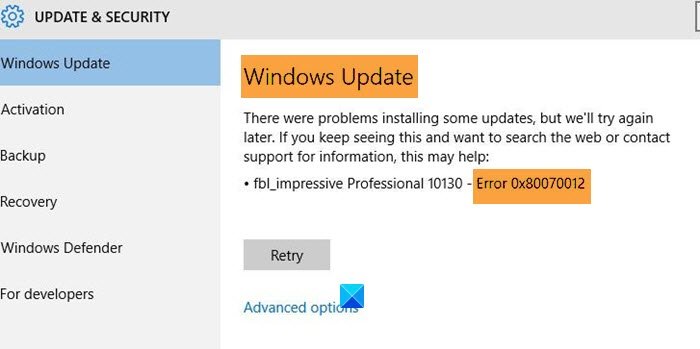

WIndows Updates are necessary for Windows 11/10 systems, especially because they push security updates to the computer. However, at times users encounter Windows Update error 0x80070012 while trying to update Windows 11/10. In such a situation, read through this article for the resolution.
How to fix Windows Update Error Code 0x80070012
The issue could be caused either by stuck Windows Update services or by system file corruption. Try the following solutions sequentially to resolve the problem:
