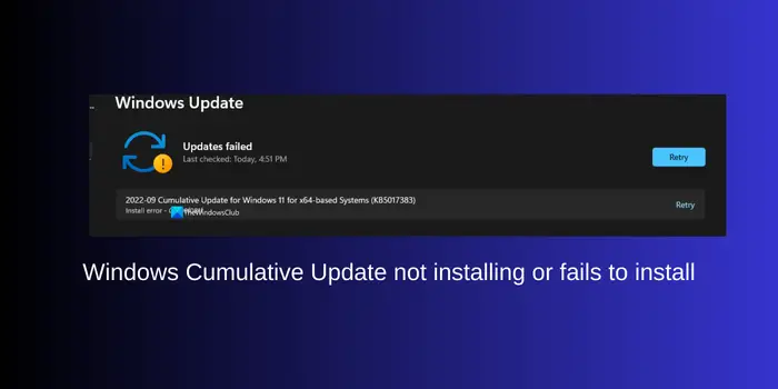

At times, you may find that the Windows Cumulative Update is not installing or fails to install on Windows 11/10 PCs. When you face the issue of Cumulative Update not installing or failing to install on Windows 11/10, with error codes 0x80070020, 0x80073712, 0x80070002, 0x80070003, 0x800F0923, 0x800F0922 and 0x800f081f, this guide will help you fix it.
Why Windows 11 cumulative update fails to install?
If Windows 11 Cumulative Update has failed to install on your PC, it might be due to internet issues, insufficient storage space, missing system components or image files, and corrupted update components. You need to fix them to get the cumulative update installed on your PC without any issues. Let’s see how to fix the issue.
Windows Cumulative Update not installing or fails to install
When you see Windows Cumulative Updates installing errors, you see the codes mentioned here. Most of the error codes are 0x80070020, 0x80073712, 0x80070002, 0x80070003, 0x800F0923, 0x800F0922 and 0x800f081f.
You may also see an Install error followed by an error code. To fix the issue, you can use the following methods.
