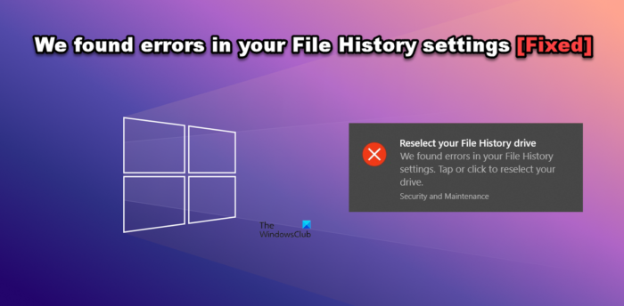

When some users tried selecting the drive they were using to store their File History, an error popped up stopping them from accessing that drive. The error said – Reselect your File History driver, We found errors in your File History settings, Tap or click to reselect your drive. If you face this issue, this post will help you.
Fix We found errors in your File History settings
If you see Reselect your File History driver, We found errors in your File History settings, follow the solutions to resolve the issue.

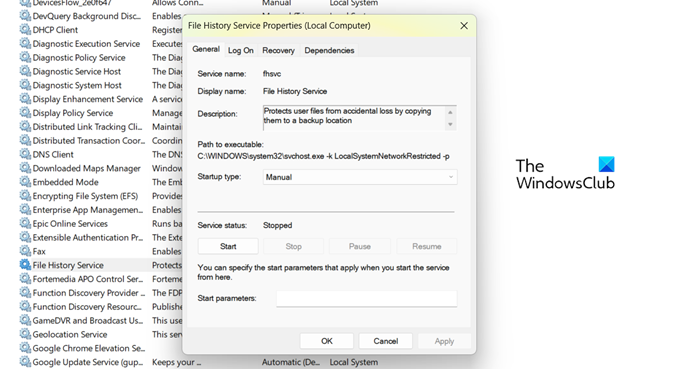

1] Restart or Start File History Service
The very first thing you should do as soon as you see the error is to start or restart the File History Service. If the service is stopped, there is no way, the backup would work on your system. And restarting will do the trick for you if your issue is a result of some kind of glitch and since we are restarting, it will allow the service to regain its ground and retry doing its job. To do the same, follow the prescribed steps.
- Open the Services app from the Start Menu.
- Look for File History Service.
- Right-click on it and select Properties.
- If it is stopped, you need to click on the Start button and it will be resumed.
- In case the service is working, click on Stop and then restart it.
Hopefully, your issue will be resolved this time.

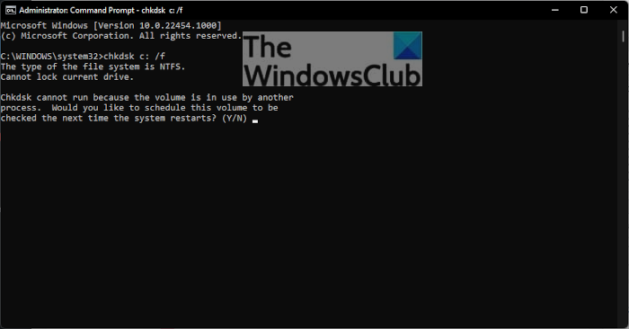

3] Repair the drive using the CHKDSK command
You may also see the error message if the error message popped up because of the corrupted disk. There are various reasons that could corrupt the disk, but there is also one tried and tested solution that you can try to repair the disk. To do the same, we will be deploying the Check Disk command. So, open Command Prompt as an administrator by searching it out from the Start Menu and then run the following command.
chkdsk <drive_letter>: /f
Note: Replace <drive_letter> with the actual letter of the drive you want to repair.
You will be asked to confirm your action, so, hit Y to continue. Once the command is executed, your disk will be repaired and hopefully, your issue will be resolved.

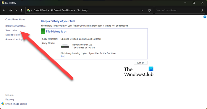

4] Reselect your drive
If the error message reappears, you should tap or click on the error message and then click on the Select device button from the right panel. Then select the device you want to use and click on Ok. If you missed the notification, just hit Win + S, type “File History” and hit enter, you will see an option called Select device. Hopefully, this will do the trick for you.
