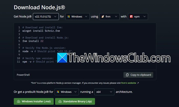

1] Download and install Node.JS
First of all, we need to install the latest version of Node.js as Codex CLI is available as an npm (Node Package Manager) package. To install Node.js, open your browser and go to nodejs.org, and locate the correct binary, LTS is recommended for most developers. After configuring, click on Windows Installer (.msi). Open the File Explorer, look for the downloaded installation media, and run it. Finally, install Node.js on your computer.

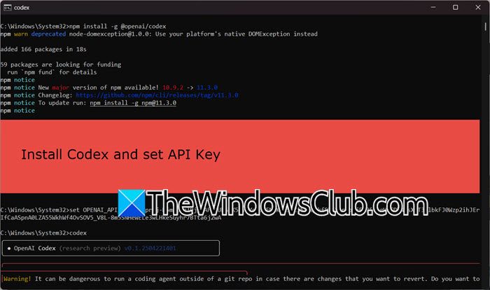

Now that we have installed Node.js on our computer, let us go ahead and set up OpenAI Codex CLI. To do so, you need to search and open the Command Prompt as an administrator. Then, execute the following command.
npm install -g @openai/codex
Wait for a few minutes as it will take some time to install Codex.

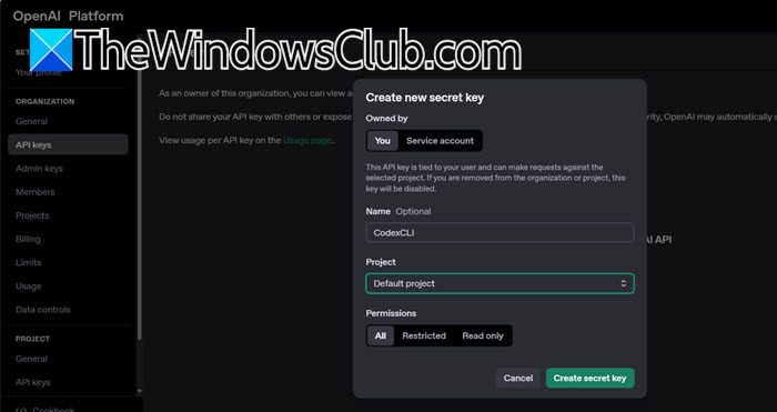

Now, we need to feed our OpenAI API key. If you don’t have one, you can create it using the steps mentioned below.
- Navigate to platform.openai.com and sign up or log in.
- Click on Search, type “API Key”, and click on the pop-up.
- Now, click on Create a new secret key.
- You need to enter a name and select a Project. Then, click on Create secret key.
- Once the key is generated, copy and place it somewhere.
After fetching the API key, run the following command to set it in your Command Prompt.
set OPENAI_API_KEY=<Copied-OpenAI-key>
Make sure to replace the <Copied-OpenAI-key> placeholder with the actual key that you have copied earlier.
Now, run Codex to start the interactive session. You will get a prompt asking you to confirm your action also stating a warning, we recommend you hit y to continue.
That’s how you can install Codex on your computer.

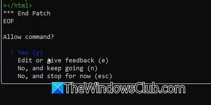

After selecting the model of your choice, go ahead and ask your question. Like, for example, Create an HTML based application to remove the background from an image. It will take some time to process the information that you have given and write code for you. You will then get the prompt to confirm the command to run, which means allowing it to create the HTML file. Hit Y to confirm.
We recommend you open the Terminal inside a folder to locate the file that Codex creates. You can open the Index.html file and run it. It will open in your browser and do what you have instructed.
