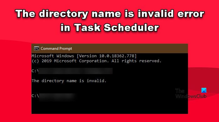

When some Windows users tried running a job using Task Scheduler they got an error. According to the victims, there is nothing wrong with the job’s script as it runs perfectly, but they still cannot schedule it. In this post, we will see what you can do if you get The directory name is invalid error in Task Scheduler with error code 2147942667 or any other.
What does the Directory name isn’t valid mean?
If the Directory name isn’t valid, you need to change the path mentioned in the “Start in” field. More often than not, a special character gets added to the path, which you can remove to resolve the issue. Hereinafter, we have mentioned every single solution that is required to resolve this issue.

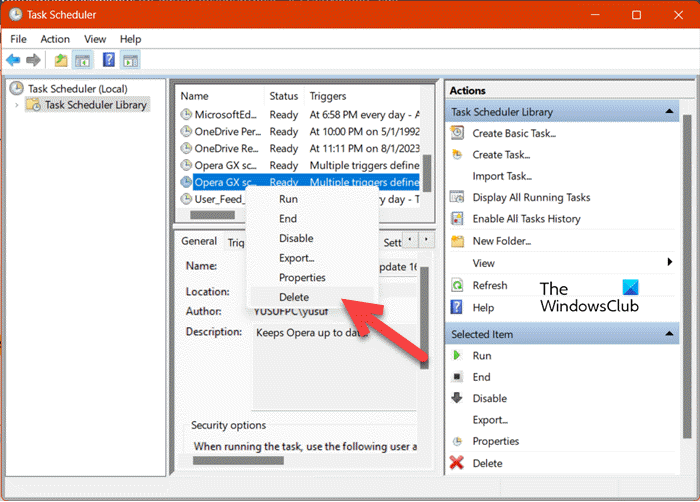

1] Delete and then add the task
It is possible that the task is not getting scheduled due to some glitch. Usually, glitches can be resolved by just rebooting the system. You should do that first and then see if the issue is resolved. However, in this case, rebooting might not work. That is why, you need to delete the task and then add it again. After doing so, schedule it and check if it’s working.

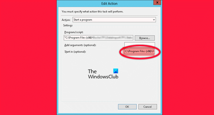

2] Edit the file path
As mentioned in the error message, the directory name, which is nothing but its absolute path is incorrect. A very common issue that a lot of users notice, a special character is being added to the path, due to which the system is unable to read it. We can pretty quickly make the modification to the path as that will do the job for us. To do the same, just follow the steps given below.
- Open Task Scheduler by searching it out of the Start Menu.
- Then click on the Task Scheduler Library from the right side of the window.
- Now, go to the task that you want to schedule, right-click on it, and select Properties.
- Go to the Actions tab, select the path, and click on the Edit button.
- Next, go to the Start in (optional) field and then remove the Quotes (” “) from the path.
- Once done, click on the Ok button to save your changes.
After making the changes, re-schedule the file and then check if the issue is resolved.
