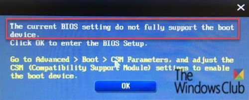

While turning on your computer, if you see an error message called The current BIOS setting do not fully support the boot device, you should go through these solutions to fix the issue. There could be several reasons why you might encounter this problem. However, here we have enlisted some of the most common solutions that we used to fix the problem on our computer.

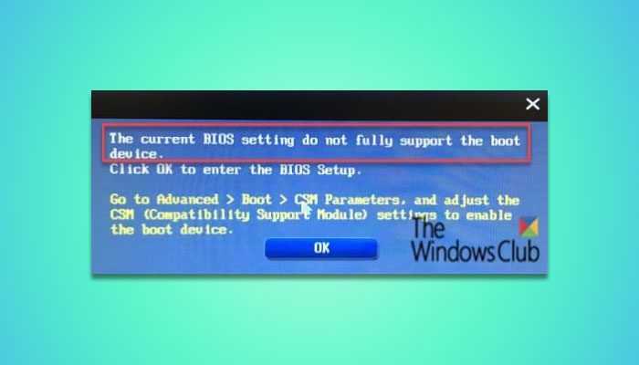

The entire error message says something like this:
The current BIOS setting do not fully support the boot device.
Click OK to enter the BIOS Setup.
Go to Advanced > Boot > CSM Parameters, and adjust the CSM (Compatibility Support Module) settings to enable the boot device.
To fix The current BIOS setting do not fully support the boot device on Windows 11/10, follow these solutions:

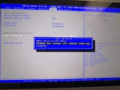

3] Check boot device priority
- Start the computer and press ESC/F1/F2/F8 or F10 during the initial startup screen to enter the BIOS Setup screen
- Choose Enter BIOS setup option.
- Since the mouse does not work, use the arrow keys to navigate.
- Go to the Boot tab.
- Now check the boot device order. Make sure your HDD is selected as the priority device.
- Exit and restart the computer.
Check if the error is resolved. If not, proceed with the next solution.

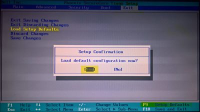

4] Reset BIOS settings
To reset the BIOS settings, do the following:
- Restart your computer and repeatedly press ESC/F1/F2/F8 or F10 during the startup to get into BIOS.
- If you are using Windows 11/10, click on Start and select Power.
- Now press and hold the Shift key and press Restart.
- Go to Troubleshoot > Advanced Options > UEFI Firmware Settings and click on Restart.
- Once you are in BIOS, press F9 to open the Load Default Options dialogue box.
- Select Yes using the arrow keys to reset BIOS settings to factory default.
On boot, check to see if the BIOS error is resolved.
