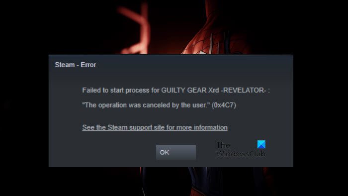

When launching games on a Windows computer, a lot of users get Steam Error 0x4C7 that says “The operation was canceled by the user“. This issue can be a result of incomplete installation, missing files, or some corrupted fragment of the game. In this post, we are going to talk about this issue and see what you need to do if you are unable to open games on Steam.
Failed to start process for <game-name>
“The operation was canceled by the user.” (0x4C7)
What is the The operation was canceled by the user error?
The error code doesn’t means that a user manually stops the operation, instead, it means that a security program or antivirus stops the application from completing the process. One can also face this issue if the game itself is corrupted and is unable to load some of its files.
Fix Steam Error 0x4C7, The operation was canceled by the user
If you face Steam Error 0x4C7 and “The operation was canceled by the user” is what you see, follow the solutions mentioned below to resolve the issue.
