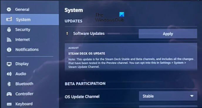

3] Update the Steam Deck’s OS, Games, and Proton Versions
If there is a disparity between the versions of Steam Deck’s OS, the game you want to run, and the Proton copy installed on your device, some functions might not work for you due to compatibility issues. So, we need to update a few things to get things on the way for you.
First of all, let’s update the Steam Deck Operating System.
- Hit the Steam button and go to Settings.
- Click on System.
- Finally, click on Check for Updates from the UPDATES section.
If there is an update, install it and restart the device.
You must then update the game and Proton from the library and check if the issue is resolved.

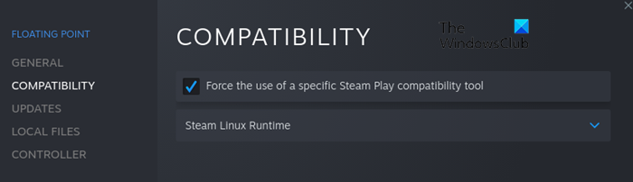

5] Switch to a different Proton version
If the Proton compatibility tool fails, you need to switch to a different Proton version. To do the same, open Steam and head to the Windows game you want to play, right-click on it, and select Properties. Now, go to the Compatibility tab, tick Force the Use of A Specific Compatibility Tool, and then select a different Proton version.

How do I force Steam Deck compatibility mode?
You can enable Proton for specific games by forcing the compatibility mode. To do the same, open and go to your game from the Library and then navigate to Properties > Compatibility, and enable Force the use of a specific Steam Play compatibility tool.
