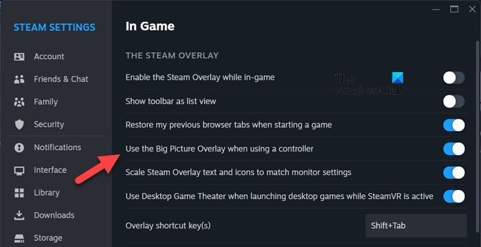

- Open Steam and then click on Steam > Settings.
- Then go to In-Game and enable Use the Big Picture Overlay when using a controller.
- Once the game is launched in the Desktop Mode, hit Shift + Tab.
- Now, go to Controller Options and then set Steam Controller Support to Forced Off.
This will do the job for you.

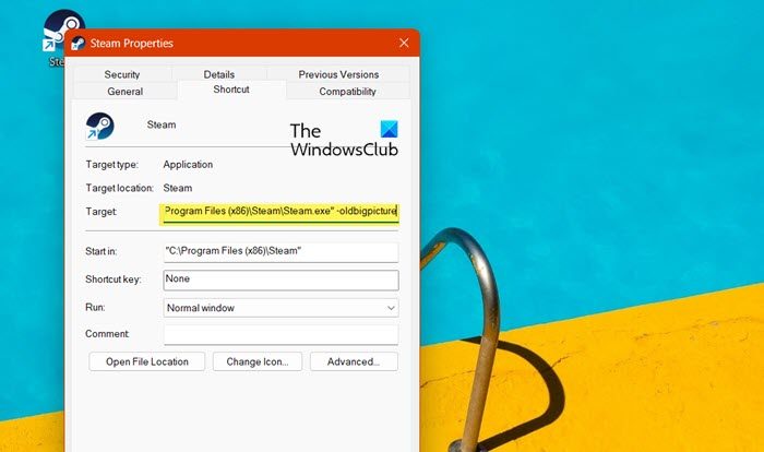

4] Switch to Old Big Picture Mode and disable Steam Input
The old Big Picture Mode doesn’t have Steam Input as one of its features. However, there is no option built into Steam to allow it to use the old Big Picture Mode. That is why, we need to change the properties of Steam to do the same. You need to follow the steps mentioned below to do the same.
- Right-click on the Steam shortcut present on your Desktop and select Properties.
- In the Target field, you need to append -oldbigpicture.
- Finally, click Apply > Ok.
Once done, you need to set Steam Controller Support to Forced Off using the steps mentioned in the second method.

If you want to disable Steam Input in any non-Steam game, you need to first start the game in Big Picture Mode. For that, just go to Steam > Settings > In-Game and then enable Use the Big Picture Overlay when using a controller. Once your game is launched in Big Picture Mode, hit Shift + Tab, go to the Controller Option, and then set Steam Controller Support to Forced Off. This will do the job for you.
