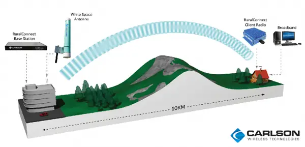

The TV White Space technology is also called Super WiFi as its reach is much more compared to normal WiFi. According to Carlson Technologies, while WiFi covers a few feet, Super WiFi can cover a range of 10 kilometers. This is almost 10 times the length that normal WiFi can go.
The major problems with normal WiFi are that they become weak with space traveled and cannot pass obstacles so they cannot be used in hilly terrains or forests. Super WiFi has no such problems. It can bend and bounce off obstacles to go ahead.
How does TV White Space work
Carlson Technologies has created a two-minute video to show how its “Rural Connect” program works. Microsoft and other companies may be using some other technique. If interested, click on the below video to check out Carlson’s answer to how does TV White Space work.

I would like to emphasize again that one ground station can cover the 10KM area (imagine a circle with a 10km radius) so Microsoft will have to use some technology to keep the Super Wi-Fi going – at every 10 km. It could be something like towers.
