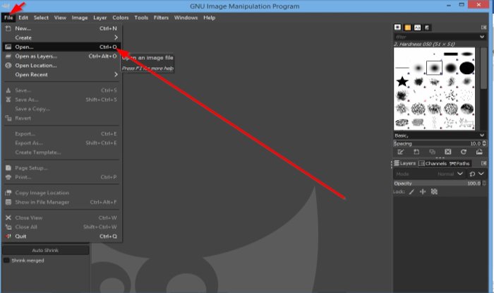

Open GIMP.
Click File.
In the file drop-down list, click Open.
An Open Image window will appear.
Select your photo file from your files and click Open.

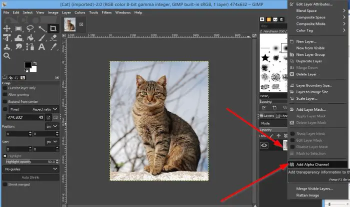

Right-click on the image layer.
In the drop-down list, click Add Alpha Channel.

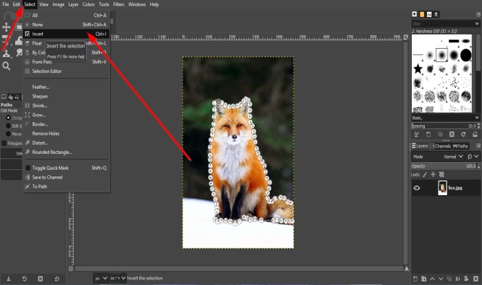

Method two is to use the Paths tool.
The Paths tool creates and edits paths.
Click the Paths tool.
Click around the image you want to remove from the background. You will see connected points that you can drag and place where you want them to go.
Press Enter.

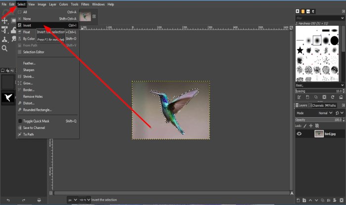

Then go to Select.
In the select drop-down list, click Invert and press the Delete key.
The background of the photo is deleted.

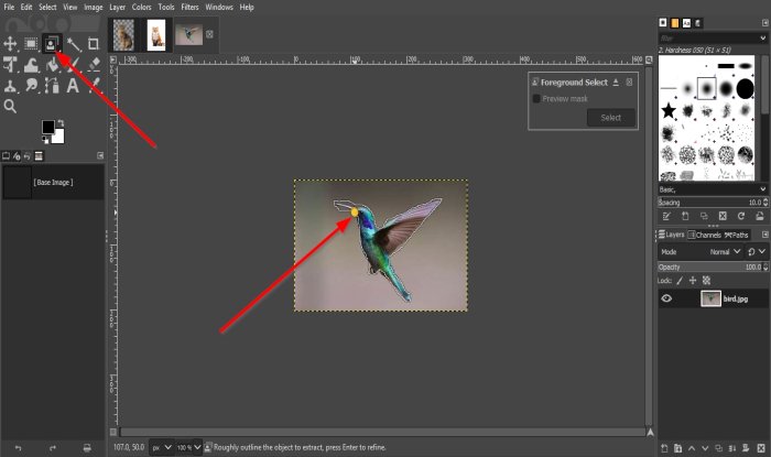

Method three is to use the Foreground Select tool.
The Foreground Select tool is to select a region containing foreground objects.
Click the Foreground Select tool and draw a line around the object.
Ensure that the lines are connected; you will see a yellow dot.
Press the Enter key on the keyboard.

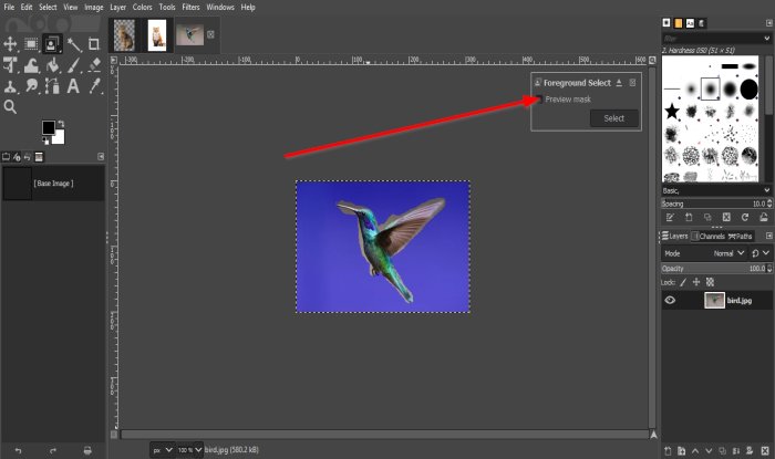

A dark blue area will appear over the image.
Now manually brush the image by click, hold and drag the brush all over the image.
Once you are finished, you can click the Preview Mask’s checkbox to see how it looks.

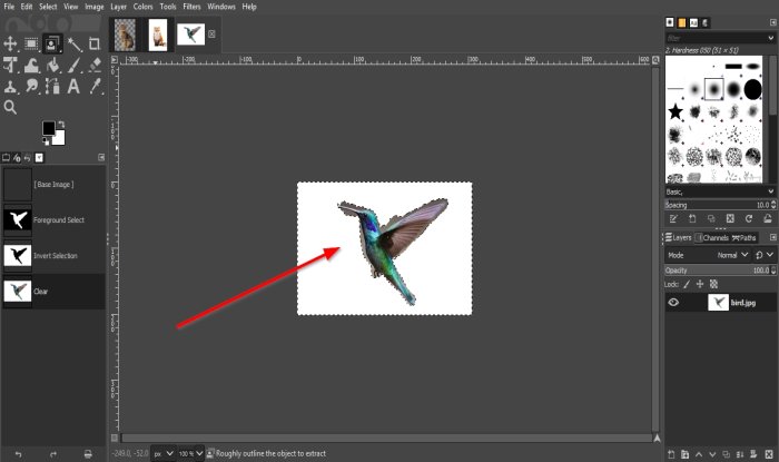

Then press Enter on the keyboard.
Then go to Select and select Invert.
Now, press the Delete Key.
The background is gone.
