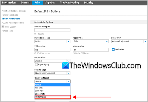

4] Disable fast printing
If the issue is not fixed, disabling the fast printing can help. Depending on your printer model, you will find the option to disable fast printing or a similar option in Printing Preferences.

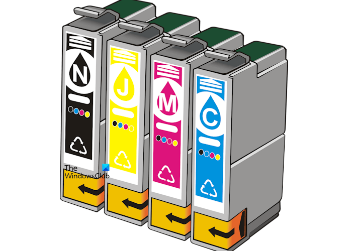

5] Test with new cartridges (if applicable)
If you see only black roller marks on the printed paper, the issue might be with the black ink cartridge. Replace the black ink toner cartridge with a new one (if available) and print a test page.

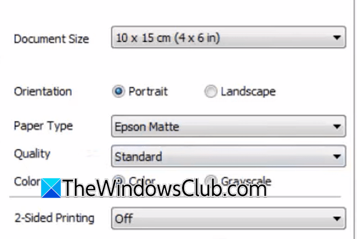

7] Change the paper type
Change the paper type to the matte paper in your printer settings. Open your printer properties to change the paper type to Matte.
