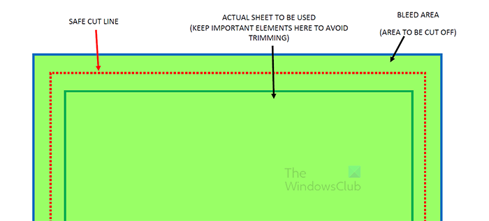

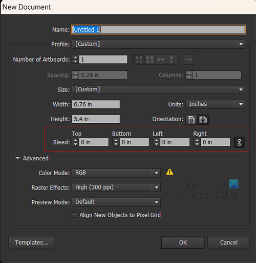

Before sending your document to the printer, do a print preview of the document. this will show the space around the document based on the target printer. You will see if any of the document is missing. If you want to have your document print without any blank showing at the right or bottom of the page, use the bleed option. This is available in some software like InDesign, or you can do so manually.
To use a bleed, you can use set it in Illustrator or similar software, this allows you to see where the document will print and where will be left off, when the document is printed, you can cut off the blank spaces. You can also choose to print on a sheet that is larger than the size that you want. You will then cut off the blank spaces around the printed document.
