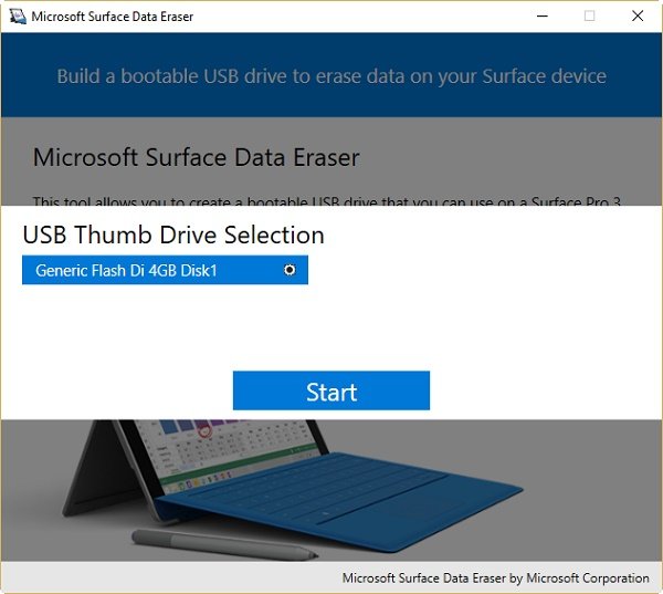

Start Microsoft Surface Data Eraser from the Start menu and click Build to begin the Microsoft Surface Data Eraser USB creation process. After that, hit the Start button to acknowledge that you have a USB stick of at least 4 GB connected.
Next, select the USB drive of your choice from the USB Thumb Drive Selection page. When done, click Start to begin the USB creation process. The drive you select will be formatted, and any existing data on it will be erased.
If the Start button is disabled, verify again that your removable drive has a total capacity of at least 4 GB.

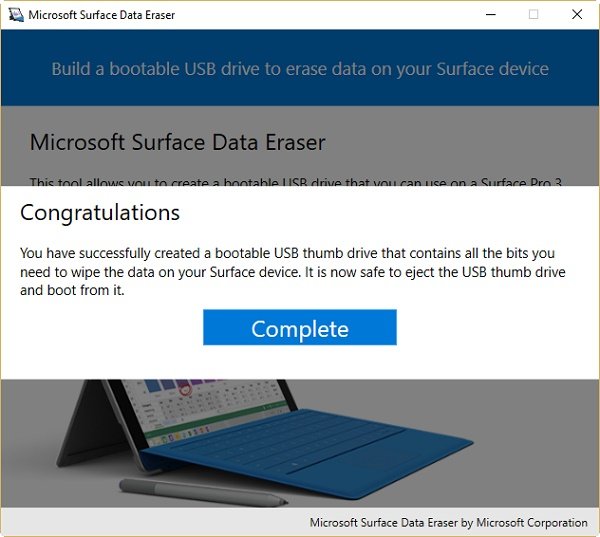

Once the process is complete, the USB drive will be formatted and all binaries will be copied to the USB drive. Click Success!
Now, when a congratulatory message is displayed on the screen of your device, you can eject and remove the thumb drive. This thumb drive is now ready to be inserted into a Surface device, booted from, and wipe any data on the device. Click Complete to finish the USB creation process.
When the process is complete, click X to close Microsoft Surface Data Eraser.

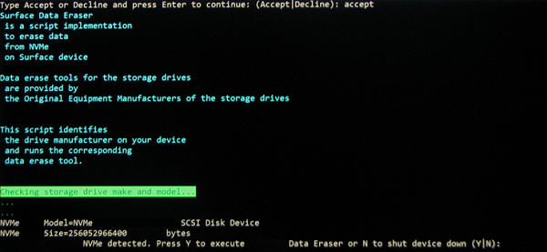

When the Surface device boots, a SoftwareLicenseTerms text file is displayed. If required, copy the contents of the text file to Notepad and do a cursory reading.
Select one of the following three options:
- Enter S to start Data Erase – Select this option to begin the data erase process. You will be prompted again to confirm the action. Ignore it and proceed further.
- Enter D to perform Diskpart – Select this option to use diskpart.exe to manage partitions on your disk.
- Now, enter X to shut the device down – Select this option to perform no action and shut down the device.
Please note – If you typed S to begin the data erase process, the partition that will be erased is displayed, as shown in the figure below. If this is correct, press Y to continue.
When you do so, an additional dialog box will be displayed to confirm your choice.
Click the Yes button to continue erasing data on the Surface device.The way it works is quite simple. All you have to do is create a bootable USB stick that can then run the secure wipe for you, all automatically. Microsoft says the data can’t be recovered, so you’re all safe.
