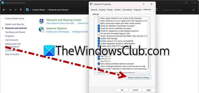

2] Reset WebBrowser control issues
The WebBrowser control in Access depends on system components like Internet Explorer settings. Access may fail to locate the required file if these components are misconfigured or corrupted. Follow the steps mentioned below to do the same.
- First and foremost, close Microsoft Access completely, then press Win + R to open the Run dialog box, type Control, and press Enter.
- Navigate to Network and Internet.
- Click on the Internet Options option, and navigate to the Advanced tab.
- Click on Restore advanced settings.
Once done, restart the device and reopen Access. If the problem persists, continue with the next solution.

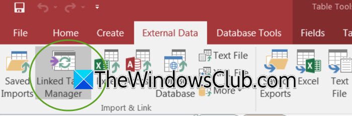

4] Verify linked tables and network paths
One of the reasons for Error 53 is when linked tables point to a back-end database or SQL Server that has been moved or renamed, or to a network drive that is unavailable. To fix this, we need to correct these links to ensure that Access can find the actual data source.
- Open the database, go to External Data, and click on Linked Table Manager.
- Check the Always prompt for new location box, select all linked tables, and click OK.
- Navigate to the correct back-end database file, select the file, and click OK.
- To eliminate drive letter issues, use a UNC path instead of mapped letters.
- If your tables are linked to a SQL server or another ODBC, select the appropriate DSN from the list, or click New to create one, then provide any required credentials and click OK.
After the location is confirmed, Access will refresh the link, then display a status dialog indicating success or failure for each tab. If any table fails, note its name and repeat the process for that table individually. Slide to the next solution if the issue persists.
