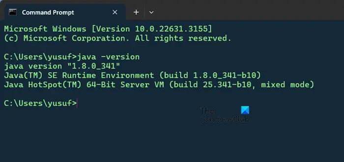

1] Check if Java is installed on your computer
First of all, we need to make sure that Java is installed on your computer. If it’s not installed, there is no way you will be able to access it from the Command Prompt or anywhere else. To do the same, open Command Prompt and then run the following command to check which version of Java is installed on your computer. If it gives you a result, Java is installed, otherwise, move to the next solution.

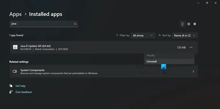

4] Reinstall Java
In case, Java is not recognized, there is a high chance that the Java installed on your computer is corrupted. So, we need to uninstall Java and then install a fresh copy of the same by following the guide mentioned earlier.
