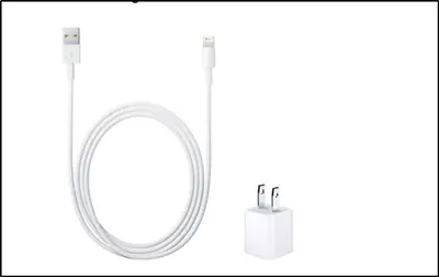

Normally, any iPhone user will use the charger shipped with the package to charge his/her iPhone. Attempting to use anything else is not recommended! Still, there are situations where we have seen people charging the iPhone by connecting it to a Windows PC. It does charge but sometimes gets disconnected. If you have been facing this issue, i.e., iPhone not charging when connected to a computer, here’s the fix for it!
