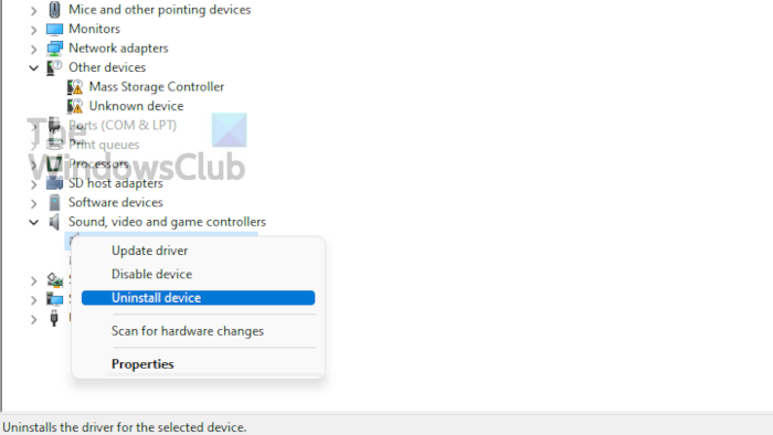

- Open the Device Manager
- Navigate to Sound, video, and game controllers section. This is usually available under Software Devices, so keep an eye out as you search.
- Expand Sound, video, and game controllers
- Right-click on Intel Smart Sound Technology
- Choose Uninstall Device.
- After the installation is complete, restart your computer to allow Windows 11/10 to use the generic sound drivers.

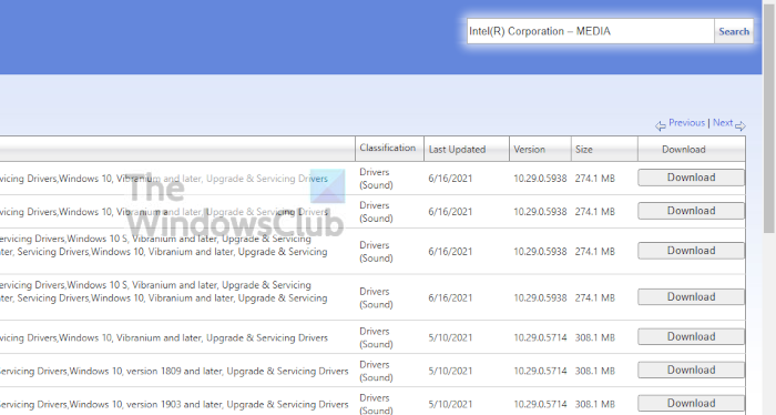

- Well, first you must visit Microsoft Update Catalog website.
- Use the search section at the top-right corner to look for Intel(R) Corporation – MEDIA.
- From the search results, locate and download Intel(R) Corporation – MEDIA – 10.29.0.5938 or later.
- Install it to your computer, then restart and check if all issues have been solved.
