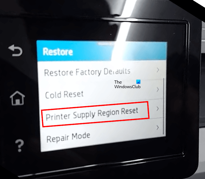

2] Reset the Printer Supply Region
If, despite installing the genuine ink cartridges on your HP printer, it is showing the Incompatible ink cartridges error, you can reset the printer supply region (if applicable). Follow the steps provided below:
- On your HP printer Control Panel, tap on the Hide option to hide the error message.
- Open printer settings and tap on the Printer Maintenance option.
- Now, tap on the Restore option.
- Tap on the Printer Supply Region Reset and then tap OK.
