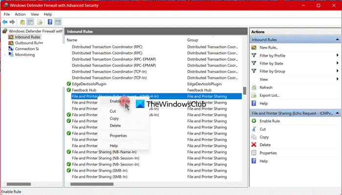

1] Alter firewall to allow ICMP inbound
Usually, firewalls tend to allow both TCP and UDP connection protocols. These protocols allow the client to form a connection with the server whether it requires the protocol to be connection-orient or connectionless. However, PING is neither TCP nor UDP, therefore, we need to configure the firewall settings to allow ICMP inbound. To do the same, follow the steps mentioned below.
- Open “Windows Settings” by searching it out of the Start Menu.
- Now, go to Firewall & network protection > Advanced settings.
- Click on Inbound settings, look for File and Printer Sharing (Echo Request – ICMPv4-In), and check if it’s allowed. If the Allow column says “Blocked”, right-click on the option File and Printer Sharing (Echo Request – ICMPv4-In), and select Enable Rule.
You will see various File and Printer Sharing options, enable all of them, and check if the issue persists. Make sure to check these settings not just on your host computer but also inside the operating system installed on your Hyper-V.

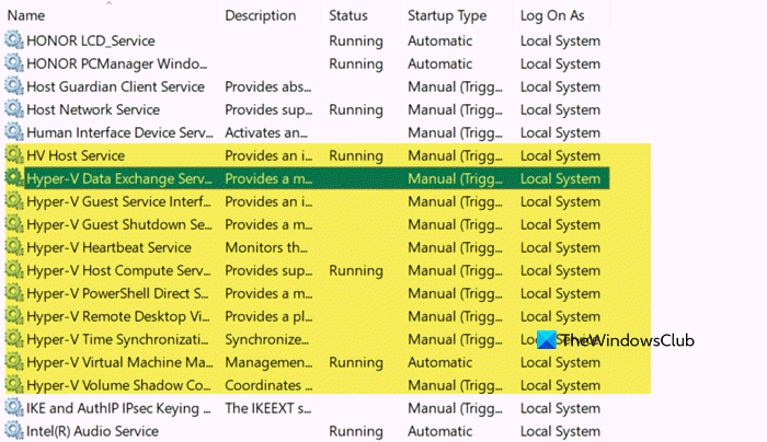

4] Restart services related to Hyper-V
Occasionally, this issue is caused due to a glitch and because of that, your VM is unable to register the change it’s being subjected to. In order to resolve it, we are supposed to restart Hyper-V services. To do the same, follow the below steps.
- Open Services by searching it out of the Start Menu.
- Now, look for Hyper-V.
- Right-click on it and select Restart if it is running, but if it’s in a Stopped state, you need to start it.
There will be multiple services related to Hyper-V, so, restart/start them all and then reboot your computer. Once your computer starts up, check if the issue is resolved.
