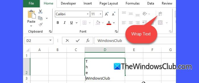

3] Use Line Breaks
In this method, instead of rotating or formatting the text, we insert a line break after each letter or word, so they appear stacked vertically in the same cell.
Go to the Home tab on the Excel ribbon. In the Alignment group, click the Wrap Text button.
Select the cell where you want to write vertically. Type the first letter. Press Alt + Enter on your keyboard. This inserts a line break within the same cell.
Type the next letter, and again press Alt + Enter. Repeat until all letters are stacked.
You can use this method not only for letters but also for stacking short words (like “Q1”, “Q2”, “Q3”, “Q4”) vertically for a neat layout in reports or dashboards.
Note: You must enable Wrap Text for this method to work properly. If Wrap Text is turned off, pressing Alt + Enter won’t visibly move each letter to a new line (though the line break is there).
