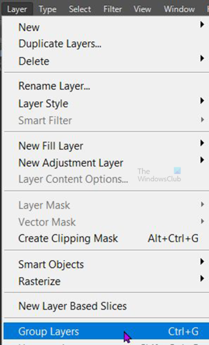

When you want to create a group, select the layers that you want to add to the group then in the layers panel go to the top menu and click Layers then Group layers, or press Ctrl + G.

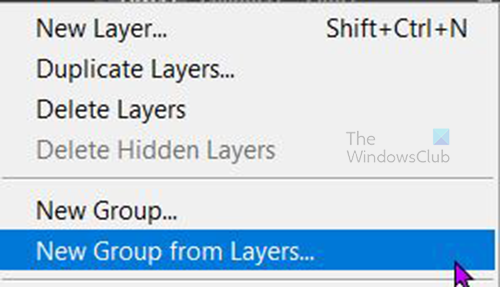

You can also select the layers that you want to group in the layers panel then go to the top right of the layers panel and click the menu button. When the menu drops down select New group from layers.

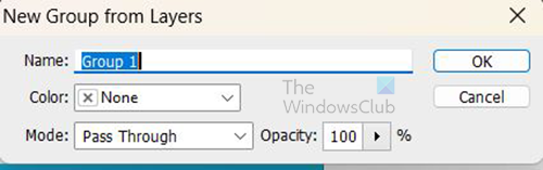

A New group from layers window will appear, you can name the group and then press Ok to confirm. If you press the menu on the layers style panel and choose New group, the window will appear for you to name the new group. You will name the new layer and press Ok to confirm. However, the layers will not be automatically added to the group. You will have to drag the layers and drop them on the new group.

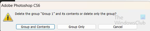

To delete the group select the group in the layers panel. Right-click on the group then choose Delete group, or go to the top menu bar and select Layer then Delete then Group.
An options box will appear asking you to choose whether to delete the group only or the group and the content or Cancel. Click the option that you want. If you choose Group only the group folder will be deleted and the layers will be ungrouped. If you choose Group and the content, the group and the layers inside will be deleted, if you press Cancel the options window will close and nothing will happen to the group.
