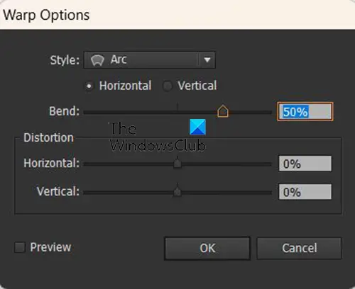

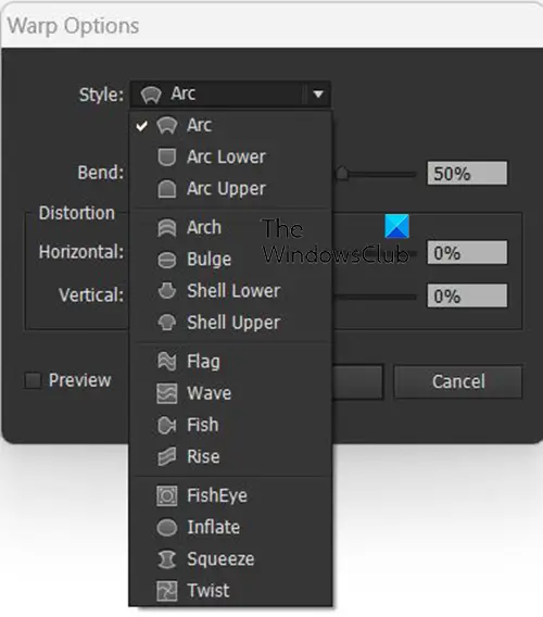

The Warp options window will pop up and you can choose the options that you want. Click the Preview option so that you can see the live changes on the object as you make them in the Warp option window.
You can choose the Warp style that you want.
You can choose the percentage of the bend that you want. You can also choose the direction of the warp whether Horizontal or Vertical. When you are finished, click Ok to confirm the changes.

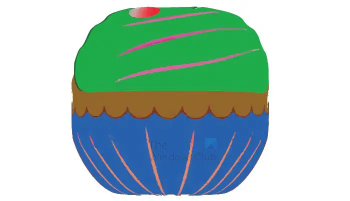

This is the finished Warp with the FishEye style, a 100% bend, and the directions (horizontal and vertical) set to zero.
After you have exited the Warp options window you can still make changes to the object by selecting it. When selected you will see the grid, select the Direct Selection tool then click on the image and you will see some handles. You can click these handles to warp the object.

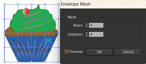

The Envelope mesh option window will appear, here you can choose the number of rows and columns. The default number of rows is four and the default number of columns is four. Click the Preview option to see the live changes as they are made on the object.

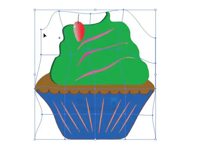

You can change the number of rows and columns to fit your need then press ok, it will seem like nothing happened, however, whenever you select the image, the mesh will be there.
To make changes to the image, select the image then select the Direct Selection tool, and click on the object. You will see some of the points change to white, grab these points and pull them in any direction to reshape the object.
This is the object with some reshaping done to it by clicking the points/handles with the Direct Selection tool and dragging in the desired directions.
If you need to make edits, simply click on the object with the Direct Selection tool and drag the handles to make changes.

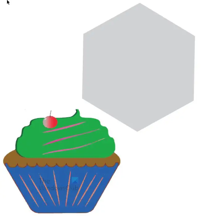

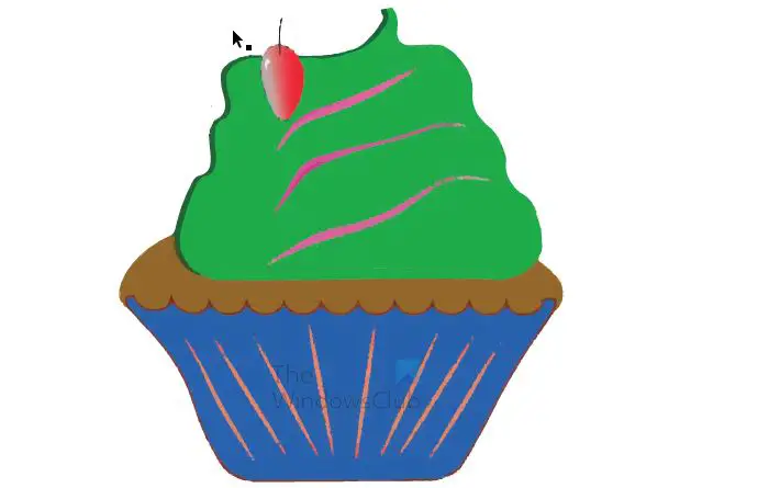

This is the original image.
To reshape the image using another image or Make with top object, choose the object to be reshaped whether text or image. You then select the shape that you want to use to reshape the object. The shape that will be used to reshape the other object has to be in front. When you create the object, right-click on it and choose Arrange then choose Bring to front. The image that will be used to shape does not have to have fill but you need a stroke so that you can see it.

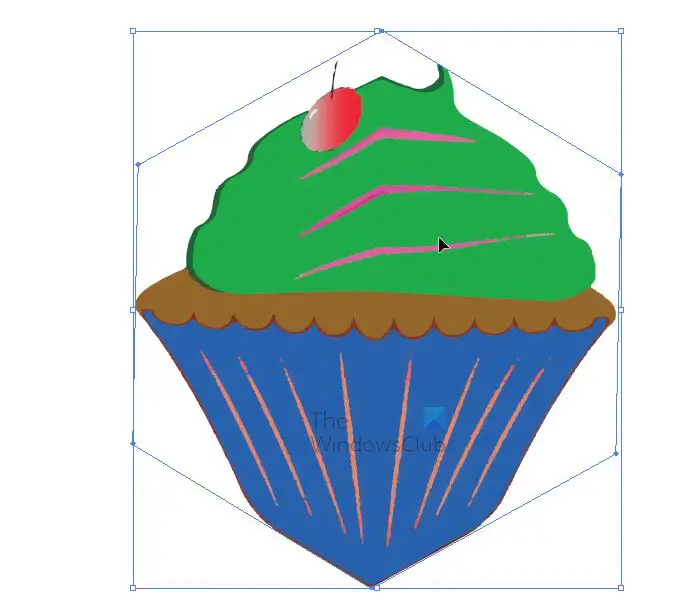

The next step is to reshape the object. In this case, the cupcake is the image to the reshaped and the polygon is the one that will be used to reshape it.

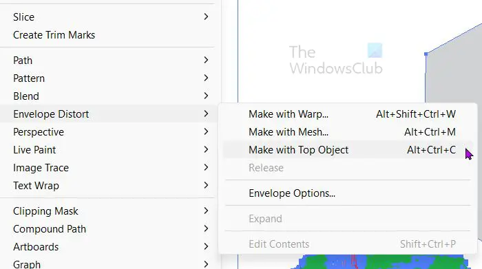

Select both objects and go to the top menu bar and chose Object then Envelope distort then Make with top object or press Alt + Ctrl + C.

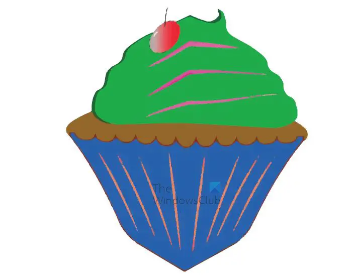

This is the image when it is reshaped by the polygon.
If you click on the image you will see the outline of each shape.

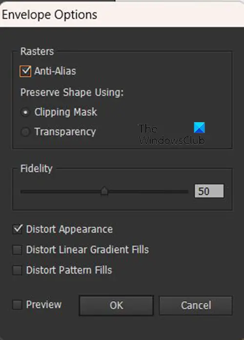

The envelope options help to make more changes to the distortion process. To bring up the Envelope option select the envelope then go to Object then Envelope distort then Envelope options.
Anti‑Alias
Smooths rasters when distorted with an envelope. Deselecting Anti‑Alias can decrease the time it takes to distort rasters.
Preserve Shape Using
Specifies how rasters preserve their shape when distorted by nonrectangular envelopes. Select Clipping Mask to use a clipping mask on the raster, or Transparency to apply an alpha channel to the raster.
Fidelity
Specifies how precisely you want the object to fit the envelope mold. Increasing the Fidelity percentage can add more points to the distorted paths and increase the time it takes to distort the objects.
Distort Appearance
Distorts appearance attributes (such as applied effects or graphic styles) along with an object’s shape.
Distort Linear Gradients
The gradient would be distorted to fit the new shape of the object.
Distort Pattern Fills
The pattern would be distorted to fit the new shape of the object.

There are various ways to reshape or curve objects in Illustrator. One easy way to curve is to use the Envelope distort. Select the object then go to the top menu bar and choose Object then Envelope distort then Make with warp. You would then click the down arrow beside the Style option and choose Arc. This will curve the object with the ends down. you can make adjustments to fit your taste. You then click Ok to conform and close. You can make edits to the curve by using the Direct section tool to move the points.
