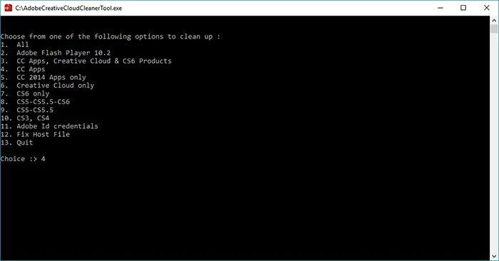

Using the Adobe Creative Cloud Cleaner Tool
- To begin using the Adobe Creative Cloud Cleaner tool, you will have to download it. You can search for it on the Adobe website or download it here.
- After you have downloaded the Adobe Creative Cloud cleaner tool file, go to the folder where it is downloaded, right-click the exe, and choose Run as Administrator. You can also double-click on AdobeCreativeCloudCleanerTool.exe if Run as administrator is not available.
- Follow the onscreen instructions in this order:
- Choose your language: Typee for English or j for Japanese, and then press Enter.
- Review the Adobe End-User License Agreement: Typey to accept or n to decline (if you decline, the script stops). Press Enter.
- Type the number that corresponds to the option you want to select, and then press Enter. For example, type 4(CC Apps) if you want to uninstall a Creative Cloud app.
- Subsequently, to remove an app, select the app that you want to remove by typing the number that corresponds to the app name, and then press Enter.
If you are facing issues with file syncing, you might have to remove CoreSync. To do this, type 1 or 4 and press Enter. Then type the number that corresponds to CoreSyncand press Enter. - Confirm that you want to remove the entry: Type y and then press Enter.
- (Optional) If you’re unable to connect to Adobe’s servers, repeat these steps to fix your host file. After accepting the End-User License Agreement, type 12 to select the host file option. Confirm that you want to fix the host file: Type y and then press Enter. The Cleaner tool creates a backup of the host file (named hosts_bkup) in the same directory, which you can revert to if a problem occurs.
- When the process has been completed the message “Adobe Creative Cloud Cleaner tool completed successfully,” will appear. you then press Enter and then restart the computer.
- When the Creative cloud cleaner tool has been successfully run, you can then reinstall the Creative Cloud or Creative Suite apps.
